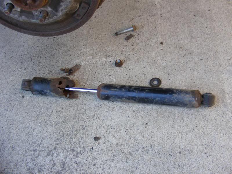

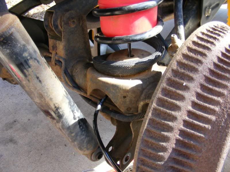

Same ones,they are pressed into the LCA's and require special tools to remove and install.I spent 3 hours trying to press one out with the correct special tools and broke the tools(which cost $200 alone),got some $1200 quotes,then just replaced the whole LCA's for way less money.With the amount of corrosion you you have good luck,your going to need it,I'd suggest a air hammer and acetylene/oxygen torch to add in removal and hope you don't damage the LCA.Really?
I check with Advance Auto and they have them for $10.99 each.
Are we talking about the same bushings? They're the ones where the strut mounts to the LCA. Not the bushings were the LCA mounts to the frame.
