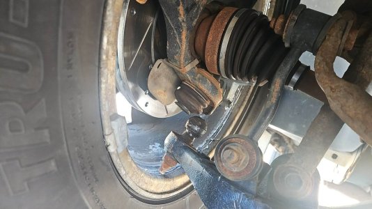

Well buddies,
part number of these lower front ball joints are 05114037 AI or AH among others that fix all libbys from 2002 to 2007
However, I wanted to buy a pair of Moog brand.
Moog has two different pieces ,one K3199 that fits 2002/2004 and K80767 that fits 2005/2007.
If Mopar uses only one for all libbys model,why Moog has different ball joints?? Anybody knows about this??
Cardhu
Aug 29, 2011
685
Great White North
The moog k3199 fit all model years. Running an 07 which has the other part number and the k3199 fit for the exact reason you listed above.
