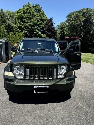

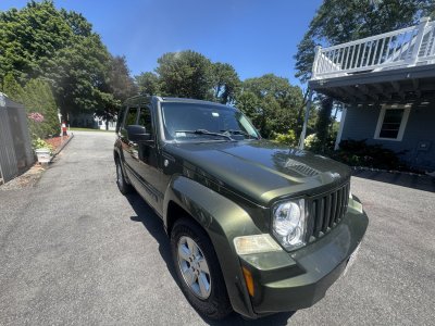

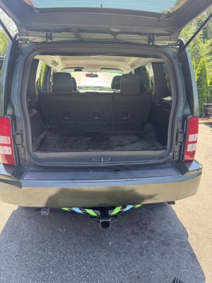

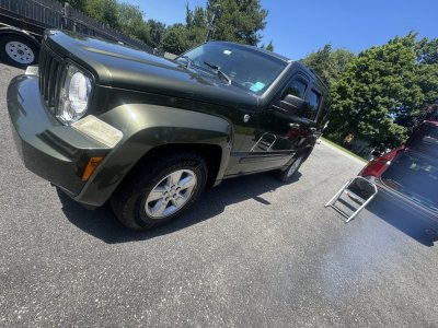

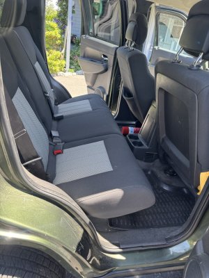

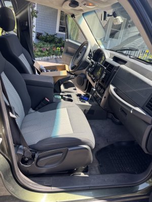

what do you all think this is worth? I am going to cut my losses. I have pout close to $6,500.00 into it, it was a dream Liberty for 5 months until it died driving home. Now with the no crank situation I have done all I can. Cleaned grounds, checked all wiring even going as far as antilock system. Still not throttle body dash light when key is on and no crank. I am going to try and sell as it sits, or will part out. I have MANY new parts sitting. new front struts, links, front rotors, that I will sell separately, and many many used parts from the 2010 I swapped the interior out with. NEW Goodyear 235/70R16 Workhorse Wranglers, cruise, etc. I was travelling anywhere with it, until 5 miles from home dash lit up and it died. I am sure I may have missed something, but have already bought another vehicle, and not a Jeep! lol! Will need to be towed. I did manage to get codes pulled and they state LOSS OF GATEWAY communications.
That’s a nice looking Jeep. What part of the country are you located in?
