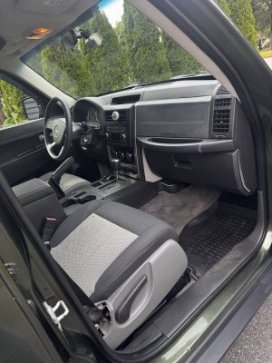

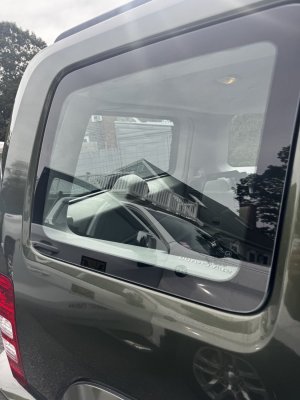

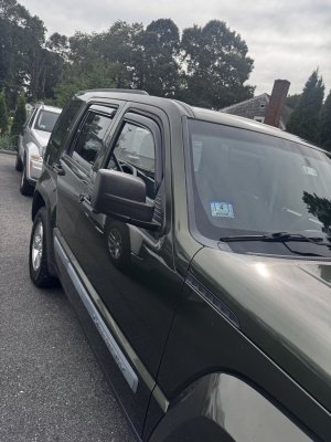

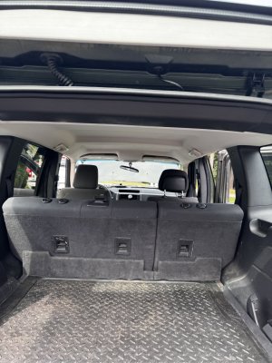

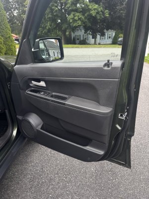

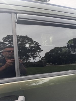

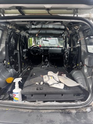

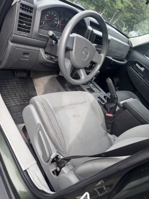

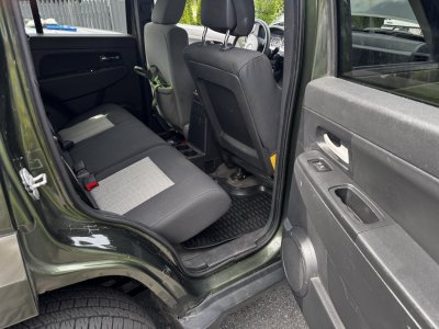

A few pics of a 4 hour strip and a partial install. I am so happy to be rid of the light gray! Hope to finish it upon this weekend. next is the back trim, cargo area, rear flipper window and will tint the fixed rear windows with 35 tint. going to pull the wheels on donor and mount my 235/70R16 studded snows.

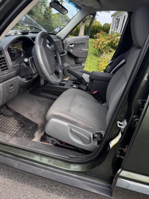

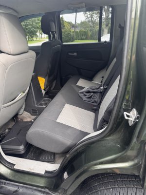

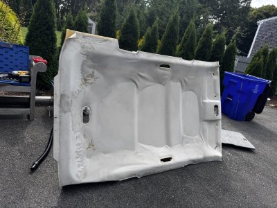

Just an update on the interior swap out. down to just the horrible light gray driver seat. headliner was swapped out today. Not too bad at all. FInally in the home stretch…driver seat, roof racks from donor and drop and save gas tank and skid plate and fuse box.
