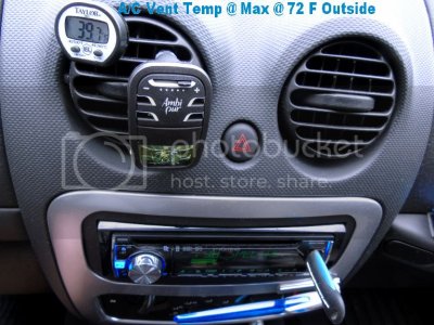

I would recommend referring to all the A/C specifications and drivers inside vent temp specs on cool/ re circulation mode/ eg,1200rpm, with a digital meat probe ($6 at wallmart)
If it is not meeting temp spec, need AC pressure gauges connected to see what's up & a potential recharge with dye= potential leak.
With probe you will then have actual vent temps for each side as well.
Hopefully it is not an actuator /blend door problem. Don't know the WK set up for vacuum stuff there.
56097[/ATTACH]"]
