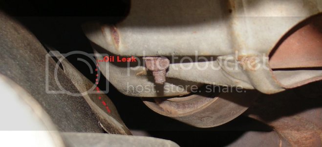

Tough to tell as the coolant reservoir is right there too but I'd bet on the back corner of the head cover gasket. That often leaks and drops on the exhaust pipes near the Cat. Makes a lot of smoke if enough is falling. Like LTC said, the smell test would be helpful. I could see mine drip on near the cat when I pulled it up on ramps and watched while idling.

Gall dang it, looks like I might be next..(banghead)
54519[/ATTACH]"]
Just a weep right now, going to get a :untitled: and tighten cover a bit.
But...If it starts to (blarg) oil I am just going to find a chrome cover, (bling) just so I can feel like a performance ricer! :signs6: :idiot: :gathering:
2,715
245
Looks like a very bad valve cover gasket. Hoping not an HG! I'd check as many of the 10mm cover bolts that you can reach. Might want to remove the coolant reservoir nuts that hold it to the studs in the firewall and try to check cover bolts near the firewall. If it's leaking that bad either the gasket completely failed or a couple are not even finger tight. Should only be about 105 inch pounds for the torque. Gaskets are not expensive and the labor isn't bad for even a novice. Just have a few things to remove to actually pull the cover.
54535[/ATTACH]"]
Tim,
What part of the engine bay is this picture of?
I've been looking around mine but can't tell whether it's leaking from the valve cover.

The leak is at the passenger-side valve cover rear...it is very close to the firewall...
You can buy the gasket for about $25-30 bucks and change it yourself...you just have to remove the airbox and intake hose from the throttle body, drain off some coolant, remove the heater hoses from the firewall, remove the PCV plumbing, and optionally, (it really helps!) the oil filler 'funnel' from the front of the passenger-side cylinder head...then you can access the cover bolts and remove the cover to replace the gasket...paying somebody $400 bucks to do that is just silly unless you are afraid of tools...good luck!

My weep is coming from above the photo area ( front passenger side by firewall corner) shows the area where its slowly accumulating.
I would have to get a mirror placed behind the cover, closer to the firewall, to get an actual photo of the weep at backside valve cover.
I stuck my finger back there, yup there is a slight weep of oil!
Sometime next week after the rain storms pass, I will tighten the cover & take it from there. Will monitor it.
