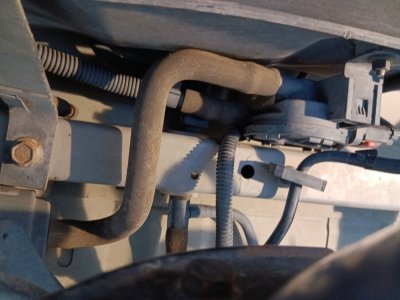

I got a "P0499 code - an Evaporative Emission (EVAP) system vent valve control circuit high,"

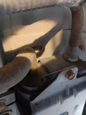

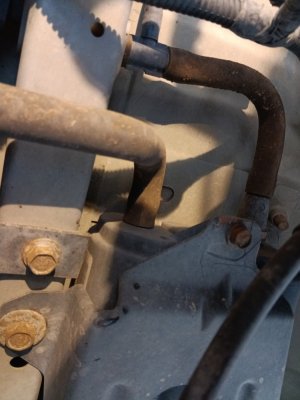

I tried searching for the vent valve location, and all I kept coming up on is the Purge Valve.. I kno that the vent valve is supposed to be located near the canister, in the under back, but can't see it, or anything near the canister that has wires going to it. What I believe im seeing, us the leak check valve...(Second pic)a three prong connector. From what I've come across, the vent valve has two prongs. There's reference to it being attached to the canister, but I saw nothing attached to it with wires.

I just replied to your other post. That's the leak detection valve in the middle photo. Not sure what you mean by vent valve - isn't that the same as purge valve? Which is up in the engine bay to the side of the battery?

Those hoses actually look pretty good - a lot better than mine were. Are there any cracks in them?
