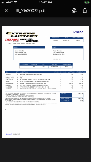

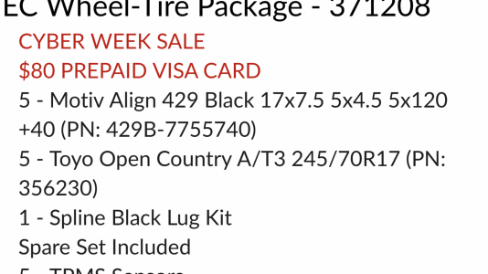

tire size ok
can't read backspacing on wheels but hopefully 7 inches wide and 4 inches of backspacing
3,656
17x7.5 +4074.10
If that is close to 4 inches ( 4074.10 does not make sense to me )
7.5 inches will stick out past the flare a bit and you may have to run extra bumpstop in the rear ( tire/wheel may not stuff fully )

3,656
NO DUMB QUESTIONS , maybe dumb answers LOL
Tearflex bumpstops in front of course
in rear 2 hockey pucks per side bolted down to the lower spring perch per side
Have you tried these wheels yet ?
a 7,5 inch wheel with +40 backspacing comes out to 5.82 backspacing
stock is 5 inches , so if above is correct wheel will not fit
3,656
Any way to make this fit?
If my computer figured this right you would need at least an inch wide wheel spacer to be almost stock
so 1.5 inches would work
