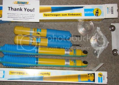

The Bilstien front shock is F4-BE5-D916-H0
The shock for rear BE5-6458-H7 is JBA's part number, and may be a custom length shock.
The Dakota spec for KJ "lifted" with OME coils, shock is what is recommended for the rear as well: Bilstein F4-BE5-A702--H0.
Mine arrived today for my 04 KJ.
