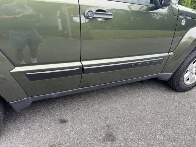

Just a little bit nothing to do today so I freshened up the molding on the side doors cleaned them up and used fusion satin black looks good, well better than that tired, worn out gray!

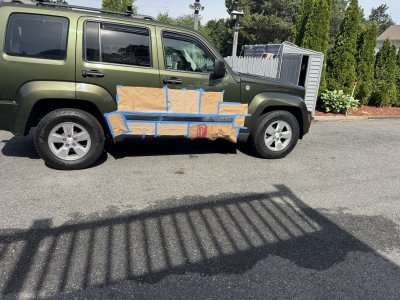

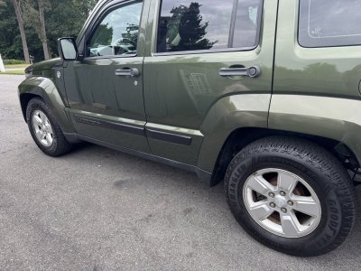

Rocker panels done and came out great! Washed in Acetone, then Fusion for 4 coats. Tomorrow the REAL test...going to the CARWASH!
