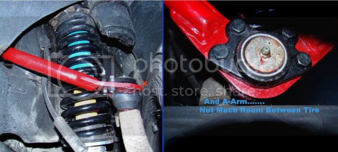

JBA 4.5 installed
JBA 4.5 A-Arms installed!
- No More spring contact
- Much more stable cornering
- Most steering twitch Gone, except over uneven surface, where tire jumps.
- Alignment done but Caster not within spec -1 degree.
Troy was PM'd and he says let lift settle, and Caster wont cause tire wear problem, and that my cross caster was in spec.
He recommends that you need to "Zero" the cam bolts first for a lifted kJ, then begin alignment. (hope I got that right)

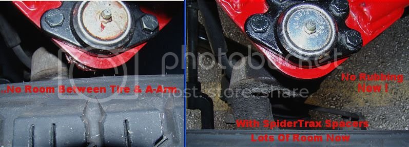

There is not much room between the tire and A-Arm.

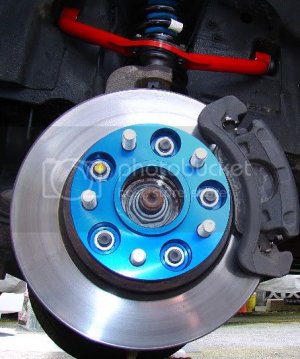

Spidertrax wheel spacers 5x4.5 x 1.25 inch are in order and should assist on inside tire rubbing with the 17 inch rims.

Edit: Update with SpiderTrax 1.25" wheel spacers installed now.
39668[/ATTACH]"]
Much more sure footed with wider track. Much less body roll. Really noticeable as flat turns now in cornering.
17 inch 245-65's were rubbing bad before the spacer install. Now No rubbing at all. Very nice to say the least.
