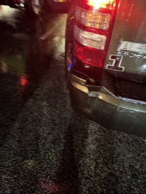

I got hit by a truck last week driver side rear bumper. It was a hard hit as it moved the Jeep 5’. However the damage was a broken bumper cover and tail light. I got a cover from Amazon and paint with a clear coat step. The cover was shipped flat so no bends. Cover came primed for paint. Should I just wipe clean with alcohol and paint?

You will need to scuff it with 400-600 grit or a burgundy scotchbrite pad. The scotchbrite pad is closer to 320 grit so go easy if you use.
I would stop by a body shop and get a small amount of wax/grease remover and buy a cheap tak-cloth. Paint away.

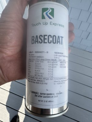

I am replacing the rear bumper cover as someone hit me. The new cover from Amazon came to me with black primer. Scuffed it up with 600 grit and so far I have 3 coats of base coat and still looks like black instead of the deep metallic green. Should I stop rough up again and use gray primer ?
