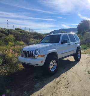

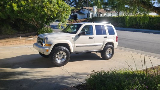

I would like to get an offset to make the tires at least line up with the outside of fender flares
My liberty is a 2002, stock height I have no intention of lifting, mayb a slightly larger tire, a little wider.
Does anyone know what offset I should look for that will work for me?
I use steel wheels from 4WheelDriveParts online. I recall they may be 3/4inch offset and they look great.
