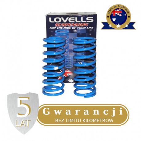

At 2.5 inches the springs should not be getting close to the JBA UC arms
That only happens when going up over 3.5 or possibly 3.25 inches so unless you are that height , no that is not the noise
The springs you are using on the front , what are they rated at ?
For example OME 927s are rated at 400 lb
For example Rustys had front lift springs that were rated same as stock, in no time they weakened and would allow the front to bounce clear down on bumpstops since this kid had not installed teraflex one, making a banging sound in front. Then it came to me to find the source and repair
that's what I found =)
thanks tom

I think its 51-100 kg extra (I have the HD version)
