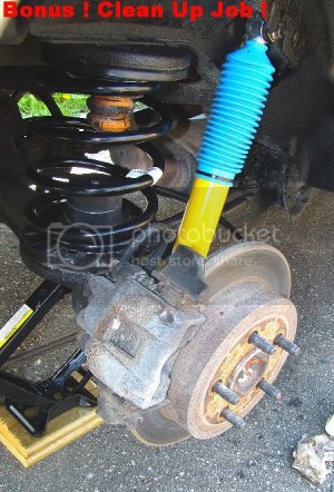

The whole process yesterday of removing the rear tires was to estimate rotor thickness and approximative condition of pads and left over percentage. We also got to test on lifted KJ, both stock and other scissor jack!
Since our (larger) measurement was just over 12mm, and the actual rotor thickness will be less, if the minimum stamped thickness is 11mm, it is time for new rotors and pads etc.
We were able to determine rotors do need replacement and that is what counts!
Also got mud off many areas!

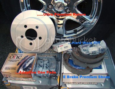

So besides my steering rack bushing woes..at 36 k miles on my KJ....
My Rear Brake Parts Arrived today!
39697[/ATTACH]"]
Everything including E-brake goodies. I can return them if not needed.

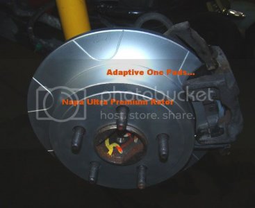

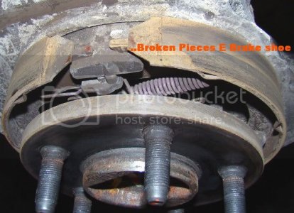

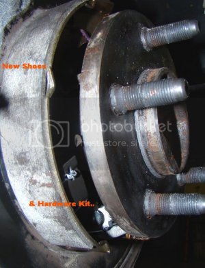

Rear Brakes All New Again!
Done in Shop, Good thing I had new E-Brake shoes & Hardware kit!
39790[/ATTACH]"]
The New Shoes and Kit work great after adjusting before and after test drive.
39792[/ATTACH]"]
Oh ya I guess the new rotor and pads shot too..

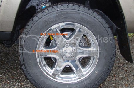

Feels much better also McGard Lugs finally.
39796[/ATTACH]"]
