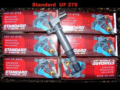

After 100k miles I would change coil packs out as a tune up item, just to be on the safe side.
I used the standards and are good alternative to the expensive Mopar's, but the Mopar coils will always be preferred.
