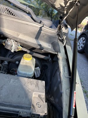

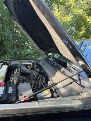

Digger, I also did the Hood prop mod. I went to the local salvage yard UPULLIT.com and removed the hood struts and ball joints off of a 2005 ford taurus. I used the existing hole and the hood hinge bolt to secure the struts. 15 minutes completed.
:rockit:I strongly suggest this mod to any jeep liberty owner.
The factory hood prop makes an excellent charcoal sorter in a barbecue pit.
