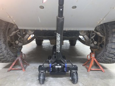

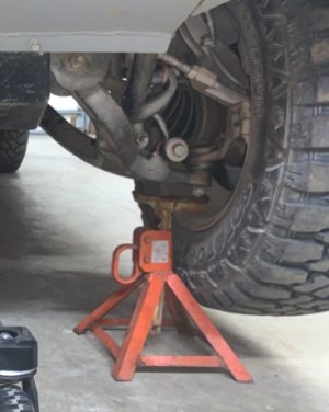

Update:
With weight on wheels on floor center of front wheel to fender was 22 1/2"
With floor jack only the Constant Velocity Joints are locked up. That was a given
With engine off. Jack stands under ball joints cvj operate smoothly. Frt drive shaft turns when I spin a wheel. Center of wheel to fender is 23 1/2. So not quite normal compression.
With engine on, in park, in part time 4WD, Each frt wheel spins with other side spinning opposite. Drive shaft not turning. Normal
With rear axles off ground, weight on axle. Engine on, in drive, all wheels spin no noise.
Take away.
I have about 2" of travel until cvj's bottom out. Not enough.
On flat, drive train operated normally.
Question.: If I go over a bump and one side cvj bottoms out, does it lock up until I stop, or bump it up to where it unlocks? Could account for squirrelly handling on gravel and chuff/thumping of locked up cv join on pavement?
