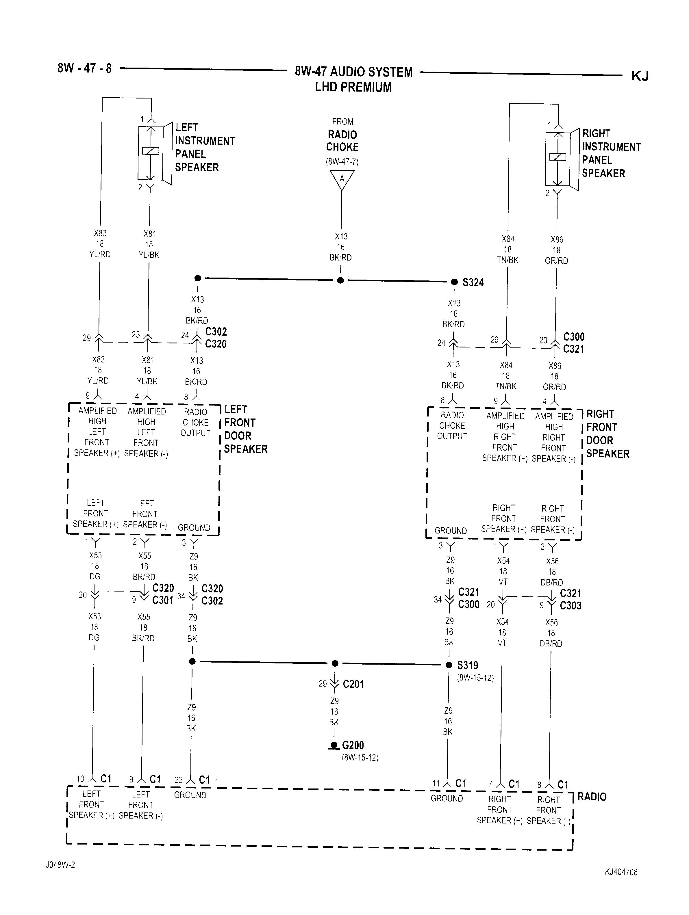

does anybody know the wiring diagram for the speakers.
they're not just black and red anymore. I've opened my right rear passenger door and found one wire brown/black , other wire brown/purple. I assume that the black woulde be neg. but i also havent opened up the other three doors yet so i dont know what color combinations i am gonna find in those.

I cant make anything out on your schematics..........
Does it say the color combos for pos. and neg. ??
Never mind....figured out the zoom function...new question..
for the rears, right side says pos. is DB/WT and neg. as DB/OR
but i have opened my right rear and the wires i have are both brown, one has a black stripe and the other has a purple stripe.
any ideas why this doesn't match up?

Check out the premium schematics, you can see + and - on them. The wires should be the same in color for either type you got.
Bennett
Active Member
Sep 8, 2004
5,387
Green Bay
Left Tweeter
Yellow/Red = +
Yellow/Black = -
Right Tweeter
Tan/Black = +
Orange/Red = -
Right Front
DB/Red = -
VT = +
Left Front
DG = +
Brown/Red = -
Left Rear
Brown/LB = -
Brown / Yellow = +
Right Rear
DB/White = +
DB/Orange = -

difference in canadian model ??????
i dunno, these schematics dont match up ,colour-wise, with the wires i have running to my speakers.

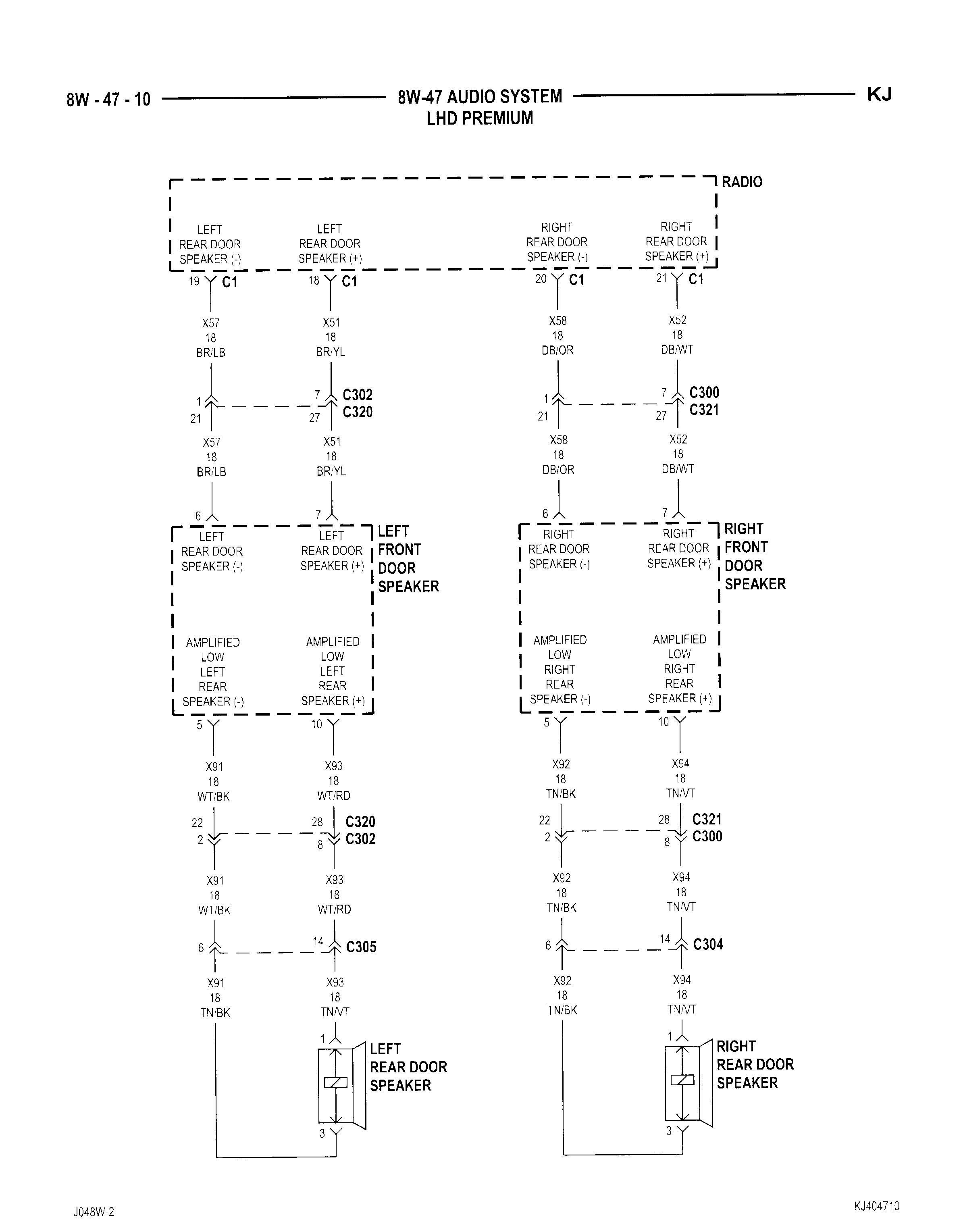

I have an 05 Liberty Sport and these colors do not match up with what is coming out of the back of my cd player. It is the six disc infinity system and all i need are the positive and negative for the back two speakers. Do you know what year liberty this diagram is from?

The diagrams are from the 04 service manual. Are you looking at the wires coming out of the HU? I would assume the wires coming out of the CD changer wouldnt go directly to the speakers, and wouldnt expect them to match.

Also, because the amp for the premium speakers are attached directly to the front speakers, you wont fine the wires for the rear speakers at the HU to match the colors at the speakers. At the HU, BR/LB and BR/YL is the Rear left, DB/OR and DB/WT is the Rear right. But at the speakers White/Black and White/Read is the Rear Left, and Tan/Black and Tan/Violet is the Right Rear. Hope this helps.

They may have change the color codes for the right rear speaker, from tan to brown. In my 04 the right tweeter's (+) wire and the rear right speaker (-) were both the same tan color. And the first time i swapped out my speakers, i mixed them up. Maybe someone got smart and realized in the 05 that they shouldnt be the same color.
