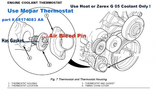

Did you get the thermostat in facing the proper way? If it’s backwards, it’ll do exactly what you’re describing.
9,242
1,882
Use the Mopar thermostat ONLY ! The outside black rubber is the gasket.
Ensure correct orientation.
I've now moved this to the KJ General Discussion Section, as your Jeep is a 2004.
Thank you. I’ll get a genuine mopar unit.
