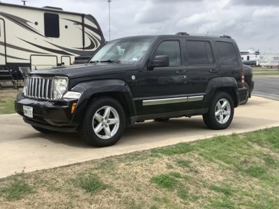

And the order has been put in.
Also have a set of Terraflex bump stops on order #1903200 cross referenced same as KK

Got the lift installed, and have have about 300 miles on it. Jeep drives great! A little stiff to me, but my last 200k miles have been in a dually Duramax. That being said I would 100% do it again, and look forward to getting it broke in. Will post an after picture later today.
