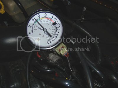

Lets see how the Jeep fares tomorrow on the vacuum test...

The misfire count was not specific to one particular cylinder.
If the needle hold steady between 15-21 in the good range, without many vibrations, or variations at idle or slightly above, I will be very pleased.
Yes, the vacuum test will give me a general idea where to go with this next if it fails.
Leak down & compression testing as well as fuel related observations will be followed if it fails the vacuum test.
The vacuum gauge gets hooked up the the PCV line.
9,241
1,882
The intake hose elbow is removed and connected up to supplied connector.
52371[/ATTACH]"]
On the 04 at rear of intake is the PCV Line/elbow now ready for testing.
52373[/ATTACH]"]
Jeep is started in Park and reads just below 19hg.
52375[/ATTACH]"]
The needle does not waiver at all throughout the testing. Everything seems to be within a normal range and gauge responds normally from opening throttle back to 5hg and then easily at idle again to 19hg.
I think I can sleep at night now, knowing it is probably not heads or stem seals/valves or intake etc.
Back to fuel injector or coils or?
This is really a different experience for me. Normally I can diagnose so much easier.
With the Jeep so computerized, and no check engine lights, might as well just forget it, until I do get an engine light!
