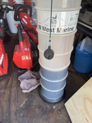

Did A NICE DRIVE THIS AM. then parked in driveway up on my ramps. gave it 3 hours to cool off from the operating temp to just slightly 2warm. I used my fluid evaluator to suction fluid from the “dip stick” hole. I got 3 quarts out. I am sure there is more left in the pan. Tomorrow will drop pan and see what it looks like. Seems to have been scanned as really pink stuff.
