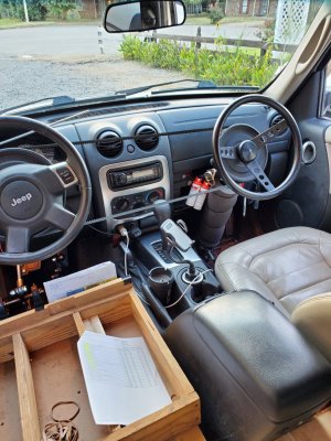

Got hired at the USPS and wife and searched the interwebs for a vehicle close to us.
So this was a NEED buy. Had to have a RHD at my age (55) ...could not do the straddle and drive from the center.
Anyways...did not know anything about a KJ
It's an 02 limited.
NOW...I NEED SOME HELP
