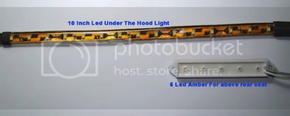

There are two puddle light wires, one taped up behind on steering column and one behind in rail on glovebox. I am not sure if you used these or tapped into map wire.
Each stock OEM puddle bulb was about 7.5 watts.
Consider that safe draw per wire.
Use 3 or 6 LED puddle lamps which draw very little, but add up per light spec, and you will be fine front and rear off one wire.
