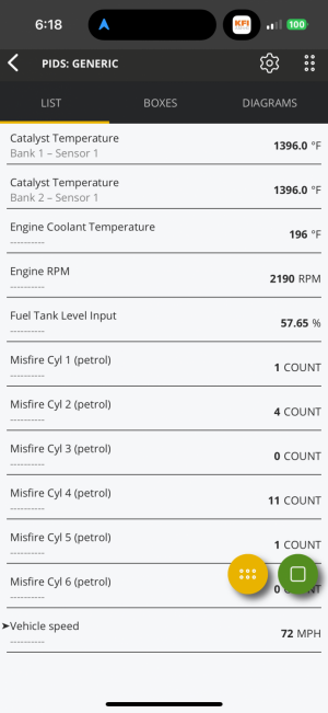

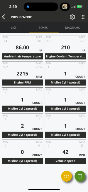

Update: Jeep running well. No hesitation or CELs. I also bought a bluetooth OBD scanner and have JSCAN app for IOS available.
Livedata shows multiple misfires, on different cylinders. No CEls. Nothing noticeable while driving. See pix. Anyone have an idea on what causes these Ghost misfires??? Plus a fun mileage pic from this morning’s drive.
