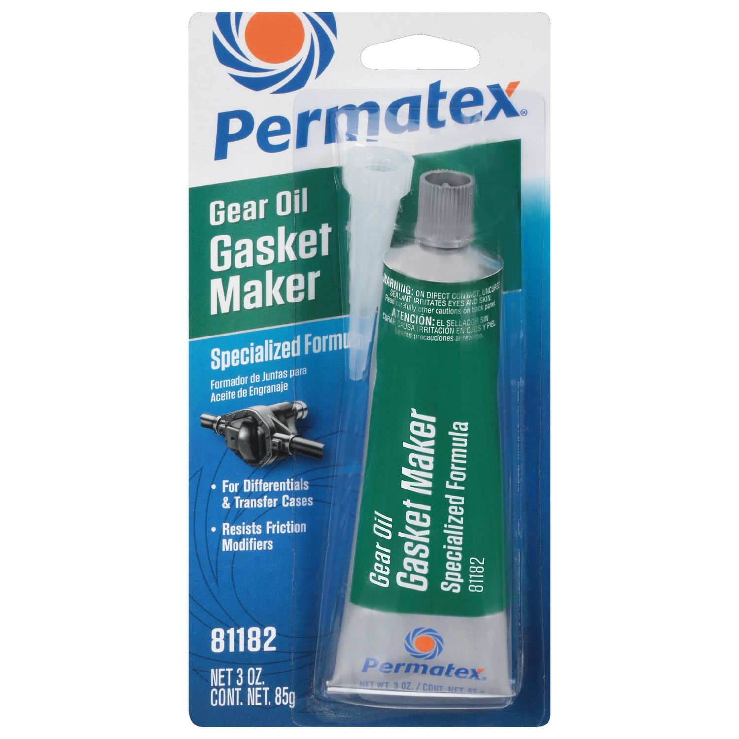

I did the rear diff oil change on our 2009 KK. You can get the cover on and off by carefully sneaking it past the sway bar. While the cover is off, I used two cans of brake cleaner and cleaned all the moving parts inside Then I took clean rags to mop up what may have dropped down below due to the spraying of the brake cleaner. Thoroughly pressure wash the diff before you start so that when you take the cover off dirt and crap doesn't fall inside.
Here is the sealant I used. I had zero leaks! I let it cure for 24 hours before I filled the diff with oil.
