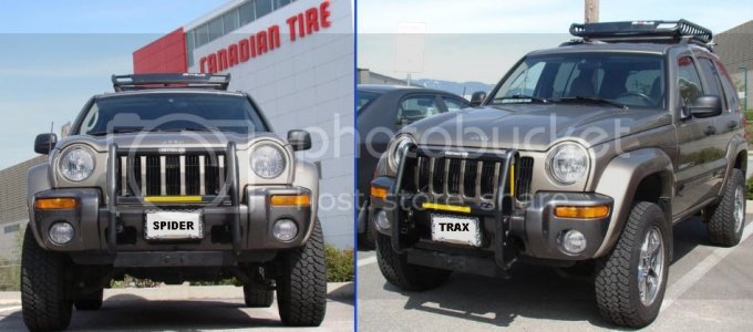

Finally not raining here, got the SpiderTrax 5x4.5 x 1.25 spacer installed.
Cleaned the stock studs with brake cleaner first, some Locktite, and ebrake held rear no problem.
A person holding the brake pedal in, without Jeep running allowed the SpiderTrax lugs in the front to be torqued in at 90 lbs.
39912[/ATTACH]"]
Even after the lift, the 245-65-17 were rubbing bad enough you could not do a tight turn going forward at all..which sucked bad.
Tire pushed out from wheel well...Tire Rubbing Be GONE!!
39914[/ATTACH]"]
What an improvement! No tire rub, much more level in turns. You could tell the roof basket was heavy and causing the Jeep to lean in turns. Not any more!
The extra width at highway speeds is sure footing.....Took a turn 45 mph was shocked!
Real Happy Now!
39916[/ATTACH]"]

Wow, what a difference in the stance. I like it. How does it ride? No rubbing issues right?
9,098
Yes Dave as mentioned above & shown in photos no more rubbing issues.
The handling is freaken awesome. Quite the improvement. Impressed.
I will have to remove all 4 tires again to check that all the new Spidertrax lugs are re-torqued again.
SpiderTrax recommends a re check at 50 miles.
This was the missing piece of the handling lift puzzle.

Thank You Bob! That is quite the compliment and I am glad your wife likes the KJ so far. It sure has come along ways since stock. After driving Ryan & Jen's rig it was so much better than my :pp: stocker! I have to say without many here in the forums, it would not have happened. You could say Ryan has been a big inspiration for me as their rig was solid and felt like a real Jeep should. Today my rig finally feels awesome enough to say.. about time!
I had it on the highway and then re torqued the front Spidertrax that were still tight. The highway run was smoother than ever felt before. The spacers have made a substantial benefit both in handling and steering without any rubbing problems. It does make me wonder now when I replace the tires if I now have enough room to run 265-70-17's? Sure would like to try ha ha...
Here are a few shots from this am. I like my KJ now a lot!
