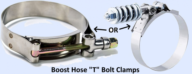

As you just found out, in the aftermarket parts game, you generally get what you pay for and if a hose selling for less then half the price of other like it, there WILL be a reason. That said, I totally understand that waiting for an out of stock item is sometimes not an option.
The silicone hoses ARE less susceptible to rotting from the oil that comes in through the EGR.
That said, like any hose, they can be damaged from over tightening the hose clamp, particularly if it is not a fully sleeved constant tension type hose clamp.

Unfortunately, the statement you replied to (the one that failed) was with regard to a Samco hose. The KBDiesel hose never even had air run through it because the port was in the wrong place.
The reason I posed the question about silicone in general was because the hose that failed is supposed to be the "best" we can possibly get.
While the clamps for that hose are sleeved and constant tension, there is a chance that they were over tightened.
I think I am going to get a rubber OEM (Mopar) turbo intake hose (so the port is definitely in the right place), and then run with an OEM passenger side turbo intercooler hose from my parts Jeep for a while. It looks to be in good condition, and the Samcos and Mishimotos only come in sets (and I only need the one).
