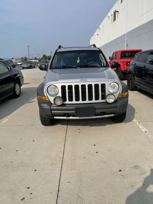

I own a 2006 Jeep Liberty Renegade! 3.7 v6 engine! I am going to rebuild it and make a few modifications to both the interior and outside!!! I have a question for you! It just started making a load noise in the front right side. Any suggestions as what it could be?

What kind of loud noise?
Take a look at your front driveshaft and front half-shafts. Look for ripped boots and give things a wiggle to see if there's any excess play.

^^^ Good advice from turblediesel. Can you describe the loud noise and when it happens? Clunking vs. Rotational? All the time vs braking vs accelerating vs cornering vs straightaway?

It is more like a howling sound! When it is more loud when she is cold.
