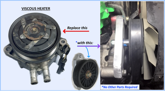

The viscous heater is worth checking too, a worn bearing in there makes a racket.
