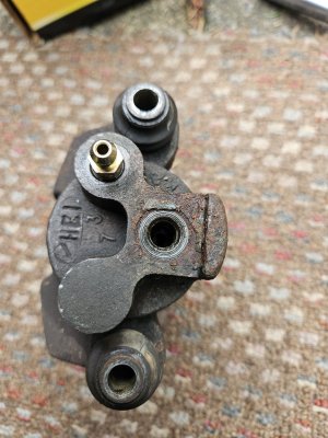

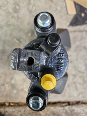

BAD -NAPA Adaptive One Rear Right Brake Caliper Single Piston Floating Remanufactured 2004 Liberty ABS
Original calipers are machined with round grooves to help the crush water seal
The napa caliper was missing this machining and would not seal keep leaking.
Works- BEST STOP caliper at O'Reilly
Has correct machining but left caliper different Bleader size than Right side
And the bolts are a different wrench size
Pictured is old and new Beststop caliper I forgot to take a Pic of napas part.
