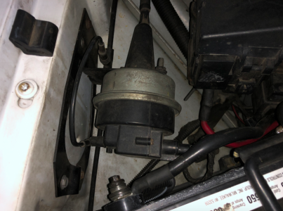

The alternator is on the driver's side, the same as in your photo. That is the AC compressor on the passenger side. Same as your photo. The alternator on your Bentley looks like the original 90 amp for the 1993 Jeep Grand Cherokee. The picture below shows the alternator in the same location but a higher output alternator.

OK sorry I had misconstrued that. indeed our bentley motor and this one you show has alternator and power steering sort of jammed up against each other. I had not noticed this smaller alternator shown in the jeep. still trying to figure out what the cruise control vacuum actuator looks like or is it a rotary spooling and unspooling motor?

I have no idea what they have done. However the 1993-1996 Jeep Grand Cherokee SERVO SPEED CONTROL looks like the pic below. The 1993-1996 Jeep Grand Cherokee cruise control servo (part number 53009315) is located on the firewall in the engine compartment, near the brake booster. Deferent makes and models deferent locations. The last picture is the same part on a 93 Comanche located on the inside fender wall. I would follow what vacuum lines they have kept and look for the SERVO "control vacuum actuator".
