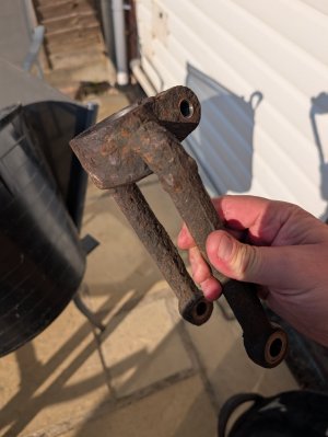

The cost effective way to go for me was to get them from a junkyard seller on eBay. Things were pretty rusty so I soaked them in penetrating oil for a week.
Eventually the bolts turned and I got them off the junk struts.
I buffed off the surface rust and hit them with Rustoleum rust converter paint and they are as good as new.

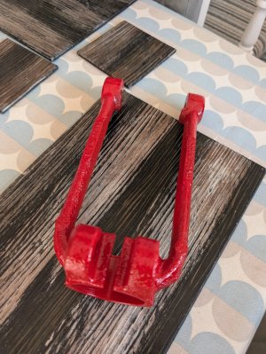

Am I the only one that decided they also needed to be red
