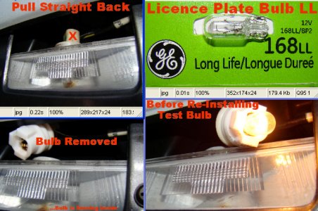

Ya seems pretty easy...but why not show it...
You can get your fingers in the rear to pull the bulb socket directly backwards.
Mine seemed glued in there, so a Q-tip and a hint of Vaseline on the socket prongs was applied, for easier removal next time.
Some burning is taking place on the inside lens, where clearance is minimal.
37606[/ATTACH]"]
Try to use LL (long Life) bulbs when replacing.
LED would be a better choice here as cooler running and no burning.
