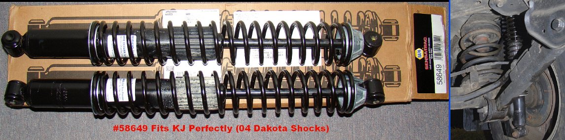

Installed these bad boys on the weekend... PN:58649 for 04' Dakota.
The spring perch needed to be ground down a bit at the outside front corner but nothing drastic. That and a few galvanized washers to take up a little slack at the mounting points is all that was required.
The shocks noticeably stiffened up the back end ... which is something I really wanted ... The front frankenlift assembly is so tight the back end (948's) always felt loose by comparison.
One thing I did not expect was an extra 1/2" of lift. I went from 22.5 to 23" in the rear. I thought it was just "phantom" lift but even after an off road beating the 1/2" remained. :waytogo:
Oh and... I have no idea yet if they actually do what they are supposed to :D .. tomorrow will be the first major load to test.

They work great, been running them for over 5 years, was the first to run them on a KJ
Haul a bunch with a 6X10 enclosed and 5X8 open trailer, plus the extra weight that I always have in the back
They bolt right on a KK by the way without cutting etc

I have used coil overs before on sedans. They do help to support some extra weight.
They initially can be a bit tight, but once you load up you will notice a positive difference!
You may even notice on the kJ the rear end holds tighter.
Look forward to your load & handling comments Luke!

Edit2-2017 I decided after blowing out the rear bilstein to install the Monroe load levelers.
49927[/ATTACH]"]
What a difference, way tighter loaded or not, less body roll.
49929[/ATTACH]"]
Awesome ride now-Thanks to Luke.
