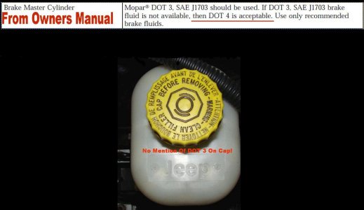

^ Interesting...So what is really going on is basically brake fluid likes to absorb moisture, therefore creating water in the brake fluid= rust from inside..= eek.
Thus the need for bleed/replenishing with all new fluid every few years.
Interesting to note that even though DOT3 is specified DOT4 seems to be a better choice as has a higher temp rating than DOT3.
[ATTACH=full]62628[/ATTACH]
Be aware that DOT4 may actually require more frequent changes than DOT3, so may not be a better choice.
http://www.stoptech.com/technical-support/technical-white-papers/brake-fluid
"This does not mean that DOT 4 fluids are necessarily better than DOT 3 fluids. Remember, the boiling points listed are minimums. There are certain DOT 3 fluids with higher boiling points than some DOT 4 fluids. The real differentiating factor is that DOT 4 fluid should be changed more often than a DOT 3 fluid, because of the effects and rates of water absorption."

Thanks, I get that Dot 3 is better than Dot 4 due to having a higher boiling point and absorbs water less.
But while I am shopping for this Dot 3 should I choose synthetic or not?
This is assuming that synthetic is available here.
And can these fluids be mixed or should there first be a complete drain of the old fluid?
