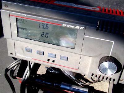

As far as I know, the KJ's system was designed with an AMP limiting PCM (power train control module) & limited to a Denso 160 amp maximum alternator.
I'm not a specialist but wouldn't the cables need to be a larger gauge and by-pass to an external volt regulator?
The 2006 FSM is here, see section 8F-26 http://www.colorado4wheel.com/manuals/Jeep/KJ/2006-KJ-SM.pdf
It would be worthwhile to consult an automotive electrical specialist, for their advice.
Larger loads also require more amps & test equipment is necessary.
