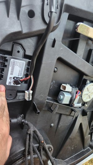

Hey all, I could use some help. My front passenger window regulator left the chat, so I went and got this one: (edit: removed link to hopefully get the post approved) . It mounted up just fine, everything lines up, so it seems it's the correct piece. BUT, I'm having issues with the wiring. I didn't disassemble it, but was assured I was given all the parts that were taken off (it's my niece's truck). The only two connectors that match are the door lock and the green-to-door lock and window button panel. The harness to regulator is different, and harness to mirror also doesn't match.. See pics attached. I'm guessing a piece of the harness is missing maybe? I've tried searching parts diagrams or door wiring harnesses for sale, but my google-fu is weak it seems. Any help is appreciated.
Edit: Neglected to mention in case it matters, 2012 KK Limited Jett

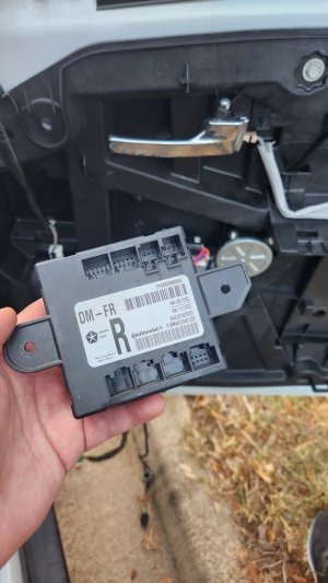

Seems there are both 2 pin and 6 pin window regulator parts, I did get the wrong one. As for the rest of the connectors, I'm missing the door control module which was overlooked and thrown away still attached to the broken regulator. Problem solved. Also, I just read the How-To Guidelines sticky... Is there a way to delete a thread?

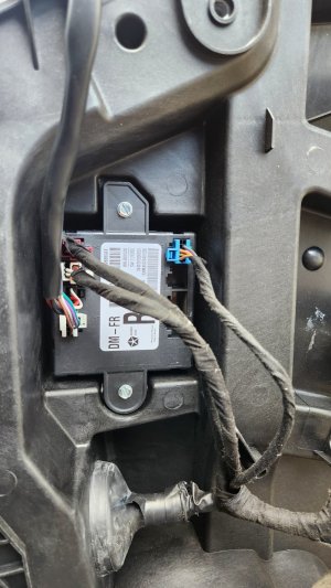

I come bearing good news, everything is up and running! All connectors to the control module are unique, so no worry there. Lesson learned, double check pin count!
