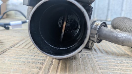

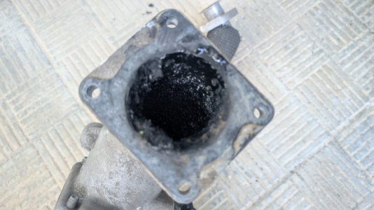

I've decided to do it by myself and had to remove the air intake and the air throttle.
The elbow was very clogged, while the valve was pretty clean.

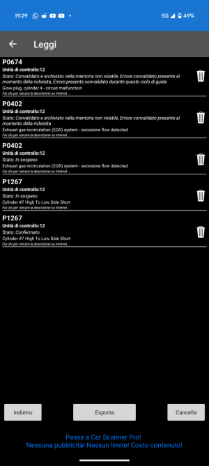

I cleaned up both, and, after mounting them back, the P0402 error popped up.

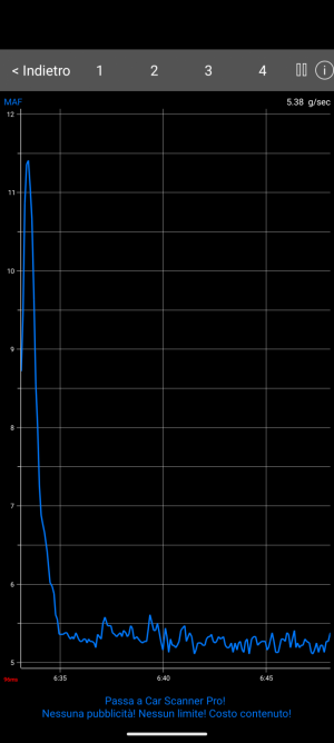

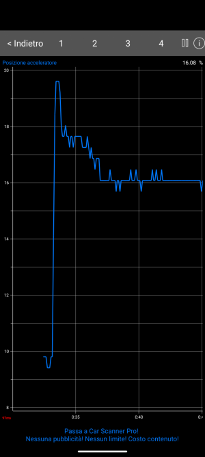

I've recently cleaned up the MAF sensor and used the Liqui-moly 5168 spray to clean up the air intake on the engine head side but the error is still there.

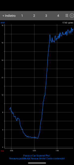

From the OBD scanner, I can see the MAF sensor value increase while accelerating.
The engine runs smoothly when in idle, but it lacks power and the revolutions don't go over 3000.
If I clear the code, it comes back after a few minutes.

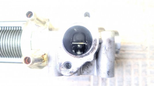

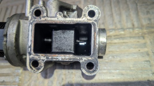

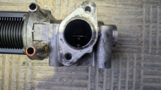

I'd guess the EGR is stuck open, the amount of carbon build-up may have been masking the issue.
The EGR system is terrible and best disabled.
Exige255
Jul 5, 2023
Thank you for your suggestion.
I've also thought that cleaning up only a part of the circuit could have caused a difference in pressure
