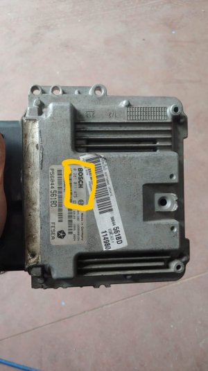

My question is about the ECU. They've sent me some pictures and it is clearly visible that the module has been manipulated.
This was done before I bought the car and I'm 100% sure about that because I saw it before but didn't realize it was opened and sealed with silicon o whatever it is.
Now the question: how can I make sure that is the original ECU for that model?
I can see that there are many for selling with the code P56044 but the second part can be different.
Mine is 561BD.
How does that mean? Can be replace by any other P56044?
I'm not sure the ECU is the problem but I don't want a manipulated one in my car.

For future reference, the code is the one highlighted in the picture. That's the model and you have to search for an ECU with the same code. The rest doesn't matter.
If you don't find somebody with a scanner for old protocols such as this SAE J1850 VPW, you can search for somebody with a Bosch scanner. They have their internal codes and will recognize the ECU.
I fixed all my problem by changing the ECU. For now the MIL is off, the external temperature sensor is showing the correct temperature, the transmission is changing properly and there is no more P0560 error.
