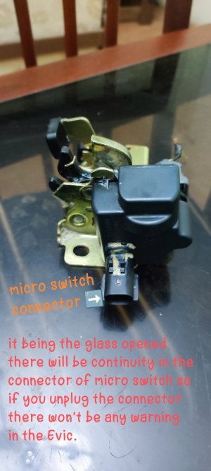

There is a tiny micro switch within the gate locker. I repaired mine adding a tiny rubber in the spot but it did not last what I wanted and ended buying an used one in the yunker. See image attached

Yeah it's built into the latch
Try spraying some contact cleaner and working the gate a few times
Might clear it up
