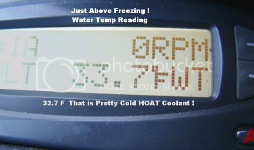

So I hop in, turn the key without starting it, and observe what kinda temperatures are now reading for water temps....
54335[/ATTACH]"]
I would have never thought that the strong-50c Hoat coolant would have been that close to freezing!

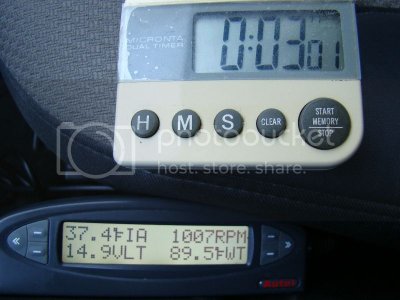

At idle now 3 minutes, reads 89.5F enough to turn on the defrost blower to High.
54337[/ATTACH]"]

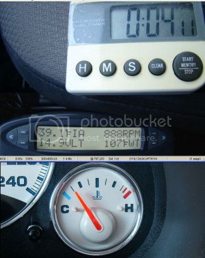

A minute later, the windows are now getting defrosted, and dash temp is climbing nicely.
54339[/ATTACH]"]

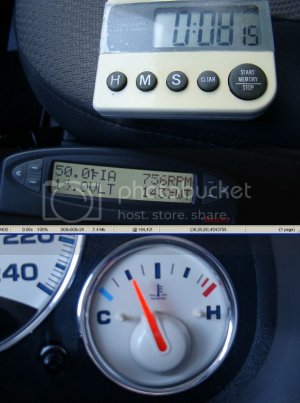

By 8 minutes the temp gauge is at the 1/4 mark, where I feel comfortable enough to drive off, with good heat now !
54341[/ATTACH]"]
The mixture ISN'T close to freezing. Antifreeze severely drops the freezing point of water when in solution.
Just because the fluid is cold and close to the freezing temperature of water, does not mean it's close to freezing.
