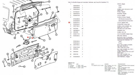

Getting this message in the EVIC...even though the glass is closed. I took the tail gate trim panel off and poked around and didn't see anything awry. Tried some contact cleaner on the plugs for the sensor and still got the error, unplugged it and the error went away. It looks like to me the latch and sensor are all one unit. Anyone have a part number?
Thanks!

Thanks! I should make sure that the issue isn't in the harness first though.

Yes check to make sure that connections are good, I wonder sometimes how waterproof the connectors may be as well.
