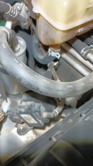

Oct 25, 2021
53
57
Arizona
On my 2005 KJ, this vacuum line (with red zip tie) broke and it disabled the cruise control and the air flow switch all at once. Replacing the line ($15 part from dealership at the time...years ago) fixed both problems.
