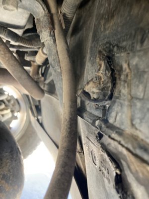

The puncture appears to be more of a gouge and a knife like cut into the tank above the horizontal joint between the upper and lower part of the tank. (I will get some pictures where I can get it jacked up and get under it much better.)
My question is about gas tank repair kits and their success rate? This is a plastic tank and I have never used one of these. From my initial look at the damage it seems feasible that I could sand down the area and clean it up and use a plastic gas tank repair epoxy on it.

Here is an update with pictures of the cut into the gas tank.
After doing a bit more research on this. I know my KJ has the 18.5 gallon tank and I'm now seeing that some trim models or in later years there were some with a 20.5 gallon tank. Perhaps this was more on the KK model? Does anyone know the compatablilty across these models? If I end up doing a tank replacement it looks like I could get an extra 2 gallons on board. Not a lot.. but good for an extra 35 miles on long trips.
Thanks again for looking and any info.
