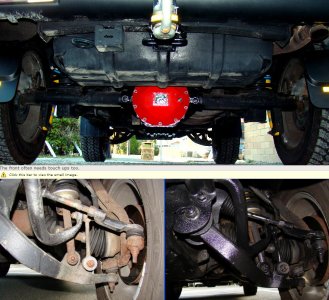

9,081
1,747
Re: The Rust- Proof that salt is bad news! :(
Every year I try to use a drill w/ wire brush attachment, & even some sandpaper to keep it at bay!
Next Professional grade Rustolium spray paint gets used to keep my Jeep looking better.
Yes it's a bit of work & well worth it in the end.
Mouse been chewing on the electrical @ master cylinder? o_O
