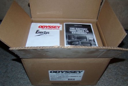

Here is the box it arrives in, (just like an X-Mas Present) and ya it's a 34/78-PC1500 DT -that drops right in. DT stands for dual terminals. :gr_grin:
Fully sealed, you wont ever have science projects on terminals again.
BTW When I got mine (which is now in the full size loaded sedan) on a $3k Midtronics load tester, new it read 1319 CCA, 3 years later it still reads 1078 CCA !
