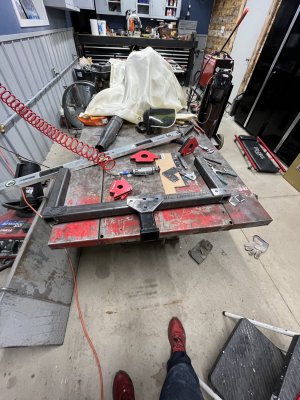

I mocked up and tacked a front hitch using the methods from a dirt lifestyle youtube video using 2 in and a quarter-inch square stock then had it burned in by a friend for 50 $ because my 110 welder was not strong enough and used grade 5 bolts to attach it underneath by tapping the square stock the stock bumper fits with slight modification.
