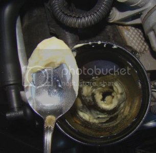

Oh look nice oily vanilla pudding !! Need a spoon? :gr_grin:
53763[/ATTACH]"]

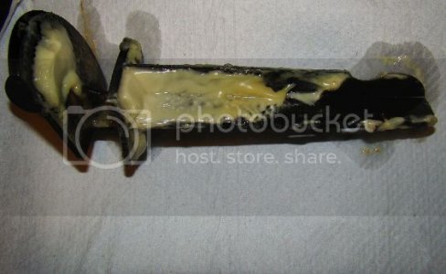

Ya that baffle can get a little nasty :icon_lol: See the condensation/ water absorbing into paper towel?
53765[/ATTACH]"]

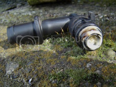

Remove the PCV filter, if it looks like this, it needs cleaning or replacement :whip:
Remove the hose from PCV first carefully. Heating it might help.
Twist it counter clockwise to straighten/ tab position/pull out to remove it.
